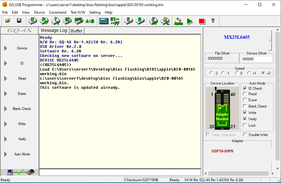

The strange thing is that the USB drivers are correct, windows recognizes the device, the GQ software recognizes the device, opens the startup window, and then after the startup window closes, the message appears in the status bar that start Failed!
"Ready
H/W Re: -(SW Re. 6.38)
USB Driver Re.2.0
Software Re. 6.38
Checking new software on server...
USB Driver Re.2.0
Software Re. 6.38
Initialization failed. Please reconnect.
DEVICE M28F102
<<M28F102>>
Load
Unknown command.
This software is updated already."

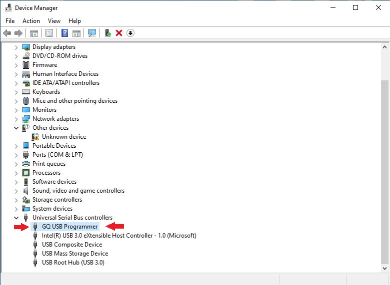

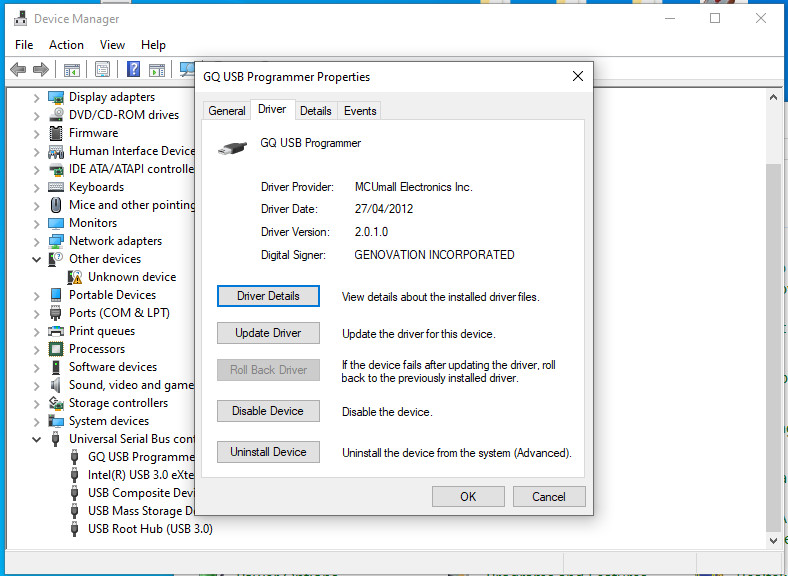

To make sure your GQ-4x is working properly, confirm that what you see in the screenshots matches that of your computer.
1 - Programmer detected in device manager:
83933 bytes
2 - Device driver is detected and working properly:
141793 bytes

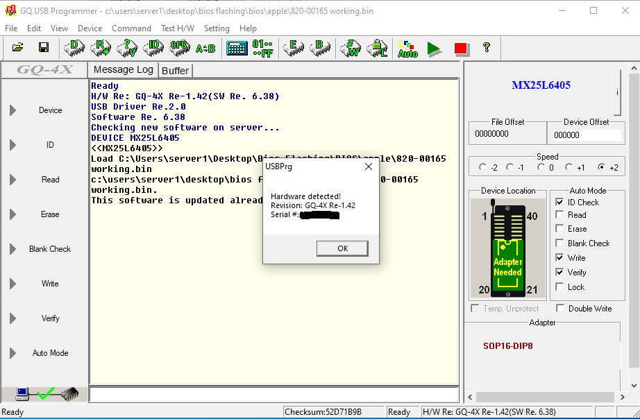

The next two steps will only work if the GQ-4X is detected properly (i am not 100% sure about this though)
4 - Run Detect Hardware:
From the GQ-4X program, on the menu bar click on 'Test H/W' then on the drop down box select 'Detect Hardware', if working the following should appear:-
158283 bytes

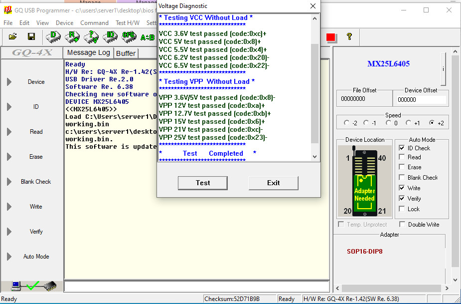

From the GQ-4X program, on the menu bar click on 'Test H/W' then on the drop down box select 'Voltage Diagnostic', run the test and if working the following should appear:-
179447 bytes
I am running windows 10 and as you can see by the screenshots, the GQ-4X is detected by the computer because it shows up in the device manager and you can see the device driver is running OK. This means that the USB hardware on the computer and the GQ-4X and the USB cable connecting them both are working. It also shows that the device driver was installed properly and is working properly.
For your GQ-4X to work, step 1 & 2 need to be working. If what you see on your screen is not the same as what you see in the screenshots then you have a hardware/device driver problem. If they are the same then you can move onto step 3 which shows the GQ-4X program running.
To confirm if the GQ-4X program and programmer are working you need to run 'Detect Hardware' which is under Test H/W on the programs menu bar. If the program can see the programmer it will display what you see in step 4, a box saying 'Device detected' and the serial number of your device. If your programmer is not detected then it means there is an issue with the software and programmer detecting one another. As has been mentioned in other forum posts, this detection will fail if the programmer is a fake one. There are many fake GQ-4X being sold which causes a lot of problems with the genuine device drivers and software that is downloaded from the official support site. Is your GQ-4X a genuine one purchased from MCUmall?
The last step tests the integrity of the programmer by checking if all the voltages are working. If any of these fail then the programmer is faulty.

wabard
Posted - 02/01/2023 :  16:35:25  Show Profile  Reply with Quote
I have not used my GQ-4X programmer in several years (purchased in Dec 2011).
Installed the software on my current computer (Win10) along with the registered drivers for the OLD version of the GQ-4X.
Drivers installed and confirmed via Device Manager.
USBPrg start, initializes and then hangs with a "Please wait..."
I have to force a close due to "Program not responding".
Anyone else having this problem and have a solution to fix it?
OS: Windows 10 - Build 10.0.19045

Fruitcake
Posted - 11/05/2023 :  14:09:47  Show Profile  Reply with Quote
I have this issue also, but unfortunately not a solution to it.
My GQ-4X works successfully under Windows 7 64 bit, but I'm setting up a new hard disk with Windows 10 64 bit (I finally thought it was time I upgraded) and have found that, although the application software and signed driver install ok, the application hangs at "Please Wait" when starting up and never recovers. Unplug the USB cable and the application unfreezes, but of course with an error "Hardware out of synched! Please re-connect the programmer" since it can't communicate with the GQ-4X.
I have exactly the same version of Windows 10, which is the latest available at time of writing. I wonder if this explains why others a few years ago reported their GQ-4X works under Windows 10 because they were running an older version of Windows 10. Does anyone have the GQ-4X successfully running under Windows 10 64 bit version 22H2?

Posted - 11/15/2023 :  12:39:17  Show Profile  Reply with Quote
GQ-4X should still work with Windows 10 latest version.
Just make sure the signed USB driver Re2.01 is installed. Do not install the 3.0 USB driver which is for GQ-4x4.
Here is the signed USB driver Re2.01:
https://www.mcumall.com/downloads/download.asp?DownloadID=55

Fruitcake
Posted - 11/19/2023 :  15:44:23  Show Profile  Reply with Quote
I am using the signed v2.01 driver, but it just hangs at start up when trying to detect the hardware. I've resorted to setting up a Windows 7 VM and it works from there, but on the host Windows 10 PC it just hangs no matter what I try.
