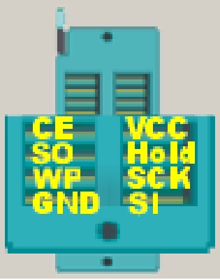

Posted - 05/26/2016 :  18:22:36  Show Profile
If your motherboard has SPI firmware update port, then it is very easy.
You can just connect the port to the programmer ZIF socket with following connection. Keep the connection as short as possible.
SPI on ZIF:
42155 bytes
If it does not work well, then you can use a ADP-056 for better result.

Posted - 05/27/2016 :  02:02:59  Show Profile
Thank you very much for the information.
I'm newbie, I see you do what you tell me.
The motherboard is necessary that is connected to power adapter when connecting willem?
I do not know if spi port, in a asus motherboard h81m-c is a bios chip without soldering, with a port, I think I could connect willem there.
In other pc,s I have these ports: minipci port, DB9. pararell, and PCIex1, willem can connect through any of these ports have named?
I will try to do it slowly, because I'm learning.
Tell me one more thing, if willem programmer connect to a PC that have blocked, you may willem programmer has been affected too? I have a kind of rootkit or not exactly, which is spread by electronic devices, so that willem programmer suffer this affected anyway if I can connect, see whether it works.
If I can make progress with this and will post again.
Thank you very much for the information and your time.
Posted - 05/27/2016 :  06:33:39  Show Profile
You motherboard need to power up.
Connect all lines except the VCC.

Posted - 05/27/2016 :  10:21:39  Show Profile
Well well well, I advance.
I managed willem connect to a motherboard asus h81m-c by the SPI port.
Now, I guess, I'll have to look for chips leading motherboard to program them, because I have not clear, where they explain this?
I think there are good tutorials for the forum to add chips and other things, I'll see.
So what I see, just by connecting willem to a SPI chip, or an SPI port, and have access to program.
I have made a home cable, to do this, and I do well to connect the SPI port, but to connect directly to a SPI chip, it does not work, I'll have to think of something else or buy the adapter SPI tests.
Thank you very much, I hope to go forward with this, if you can help me a little please.
