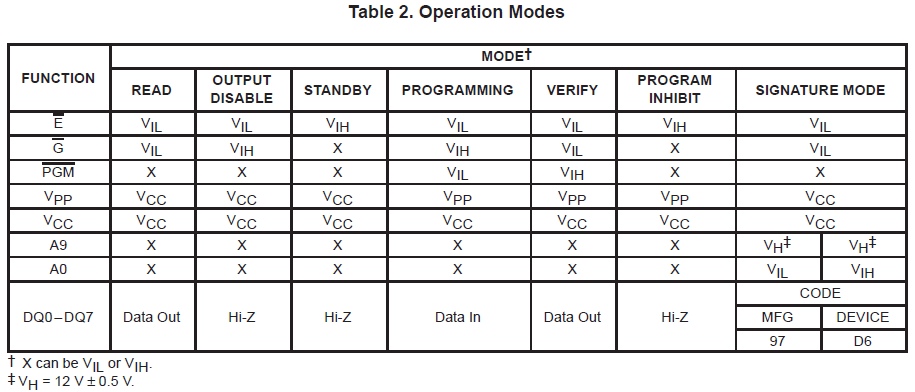

Posted - 05/02/2016 :  19:47:40  Show Profile  Reply with Quote
I believe you found the problem.
Checked datasheet on TMS27C010A, the VPP pin must be high during the reading.
The original device line does not have RVPP="5V"; That will cause the reading not stable.
See following char from the datasheet.
TMS27C0101A working modes:
130029 bytes
Reply #20
Posted - 05/03/2016 :  02:31:15  Show Profile  Reply with Quote
Yes, that's where I found the info. VPP also needs to be active to verify. I will need to test write when time permits.
