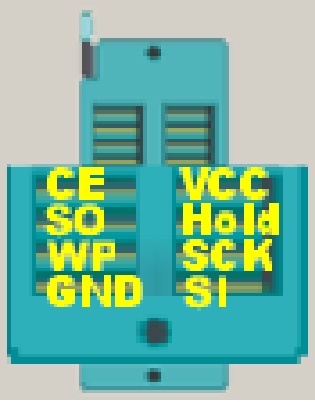

If your motherboard has SPI firmware update port, then it is very easy.
You can just connect the port to the programmer ZIF socket with following connection. Keep the connection as short as possible.
SPI on ZIF:
42155 bytes
If it does not work well, then you can use a ADP-056 for better result.

Posted - 05/27/2016 :  06:33:39  Show Profile
You motherboard need to power up.
Connect all lines except the VCC.

Posted - 05/27/2016 :  10:21:39  Show Profile
Well well well, I advance.
I managed willem connect to a motherboard asus h81m-c by the SPI port.
Now, I guess, I'll have to look for chips leading motherboard to program them, because I have not clear, where they explain this?
I think there are good tutorials for the forum to add chips and other things, I'll see.
So what I see, just by connecting willem to a SPI chip, or an SPI port, and have access to program.
I have made a home cable, to do this, and I do well to connect the SPI port, but to connect directly to a SPI chip, it does not work, I'll have to think of something else or buy the adapter SPI tests.
