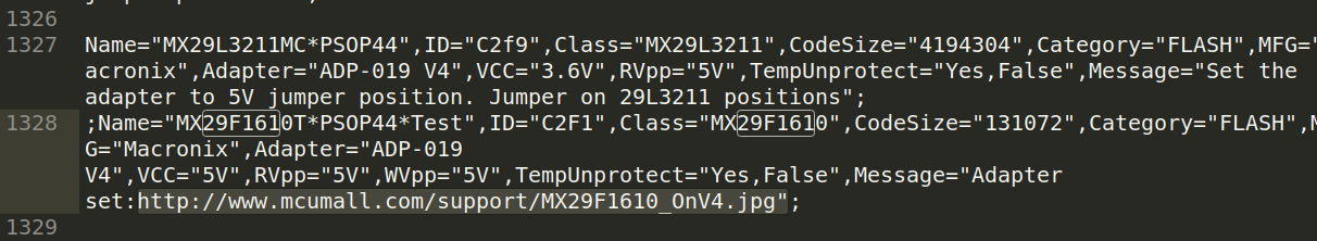

Name="MX29F1610T*PSOP44",ID="C2F1",
with this id are correct but config not !

i want burn MX 29f1610MC i have adaptor adp-019 v4
i take this:
Name="MX29F1610T*PSOP44",ID="C2F1",Class="MX29L3211",CodeSize="2097152",Category="FLASH",MFG="Macronix",Adapter="ADP-019 V4",VCC="5V",RVpp="5V",TempUnprotect="Yes,False",Platform="GQ-4X",Message="Set the adapter to 5V jumper position. J2 on 28F, J1 on 29LV160 positions";
But it's not good the j2 on 28f return unkown id, but j2 on 32l return the good id .
i think j1 on 29lv160 is not good , because i have no erase and no prog ?

Posted - 01/27/2014 :  18:17:08  Show Profile  Reply with Quote
try this version.
http://www.mcumall.com/download/TrueUSBWillem/USBPrgSetup6.27.exe
Chip is added. But not tested.

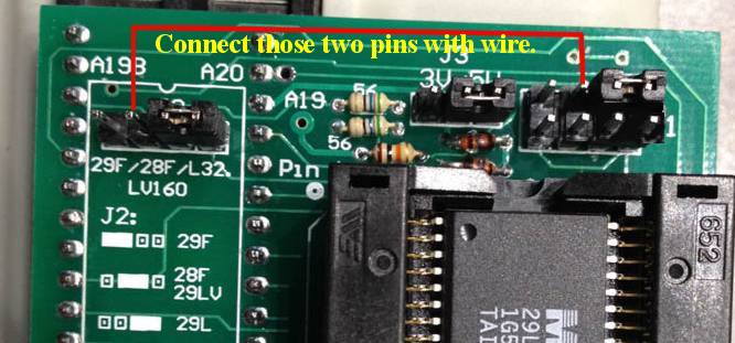

Yes. I read that, the only difference is the Pin 44. The MX29F1610 Pin 44 is WP- and it needs to be connected to the VCC of the chip when erase and write.
Other than that, all commands and pins are same.
Therotically it should work. Since your test fail, so I need a chip to find out why.
You can still try to connect that chip pin 44 to the VCC 5V pin on adapter and see if it makes different.
The picture is connect the Pin 44 to the programmer WP pin.

Ezoflash has a adapter which is almost the same lime the adp-19 from gqx4.
In this schematic he uses one 6k8 resistor to VCC to set the WP Pin to high i think.
Could anyone check this?!
Set the same settings from 29L3211 chip and solder a 6k8 resistor to VCC.
h**p://www.ezoflash.com/scriptdapters/psop44c1/schematic.htm

I'd like to know how this can be programmed on Willem GQ-4x I have an ADP-019 v4.1 adapter and MX29F1610-10 chips. I've tried using this device.
Can get chip to ID, ERASE, and Blank Check with J1 and J2 set for 29L3211. I connected a resistor between pin 44 (WP) to +5 on the adp adapter and I still cannot get it to write. Is there anyone that can help resolve this long running issue?

kodyk17
Posted - 07/21/2017 :  08:51:38  Show Profile  Reply with Quote
Is this how the adapter should look to get it to write? I'm close I just need a little advice please.
