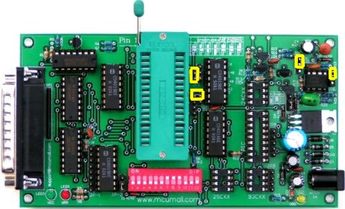

I have a willem dual power progammer. I am programming 2732A chips. I did a search for jumper settings and 2732a chips. They said to look at the software disk. I do not have a software disk for my programmer. where can i get one or download one. -Rod-

All jumpers and DIP switch setting is showed in the software once you selected the device type. The Vpp setting is not showed in the software.
For the 2732A chip the Vpp setting should be 21V.
See here, the yellow rectangles are the jumper settings:
