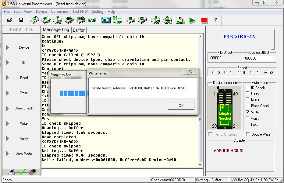

I have a GQ-4X True USB Universal Programmer question.
I have a 8051 adapter.
A new circuit is Philips NXP P87C51SBPN PPV programming voltage 12.75V
A new program is updated, with Philips added
A device ID check tells that Intel 8751 circuit is 8951 circuit, type unknown.
Should I leave ID check off?
Writing do not success to NXP P87C51SBPN circuit, it starts, but stops after 1000 addresses.

If ID is incorrect you probably have a fake chip.
http://www.mcumall.com/forum/topic.asp?TOPIC_ID=8418

You should be using ADP-015 https://www.mcumall.com/store/index.php?route=product/product&path=62&product_id=58 because other adapters might not work.

You think his adapter is not right?
