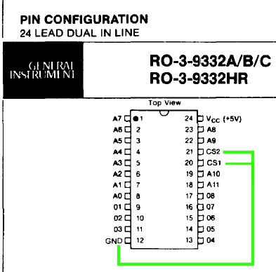

I hoping it will resolve reading 9332B OTP ROM chips -- they are 2532 compatible but whenever I read them the first half of the chip is all FF's
true 2532 eprom's read fine

I think this is it
h**p://www.datasheetarchive.com/dlmain/Databooks-1/Book241-577.pdf
The chips are very old from a pac-man arcade game circa 1980
9332B can be replaced with TMS2532JL -- which reads fine but all the 9332B chips read and the first 0x800 bytes are always FF -- I know the chips are good and work, just can read them properly in the burner
Maybe both CS1 & CS2 need turned on to read properly ?

Posted - 06/10/2016 :  15:08:19  Show Profile  Reply with Quote
Sorry for the late reply.
The 9332B has same pinout with 2532, except the pin 21 CS2 pin.
The datasheet does not have description of CS1 and CS2.
Try to connect CS1 and CS2 pins together while reading. If this does not work, then you can try to connect the CS1 to pin 12 (GND) while reading.
connect three pins together and select 2532 from GQ-4X software:
50399 bytes
