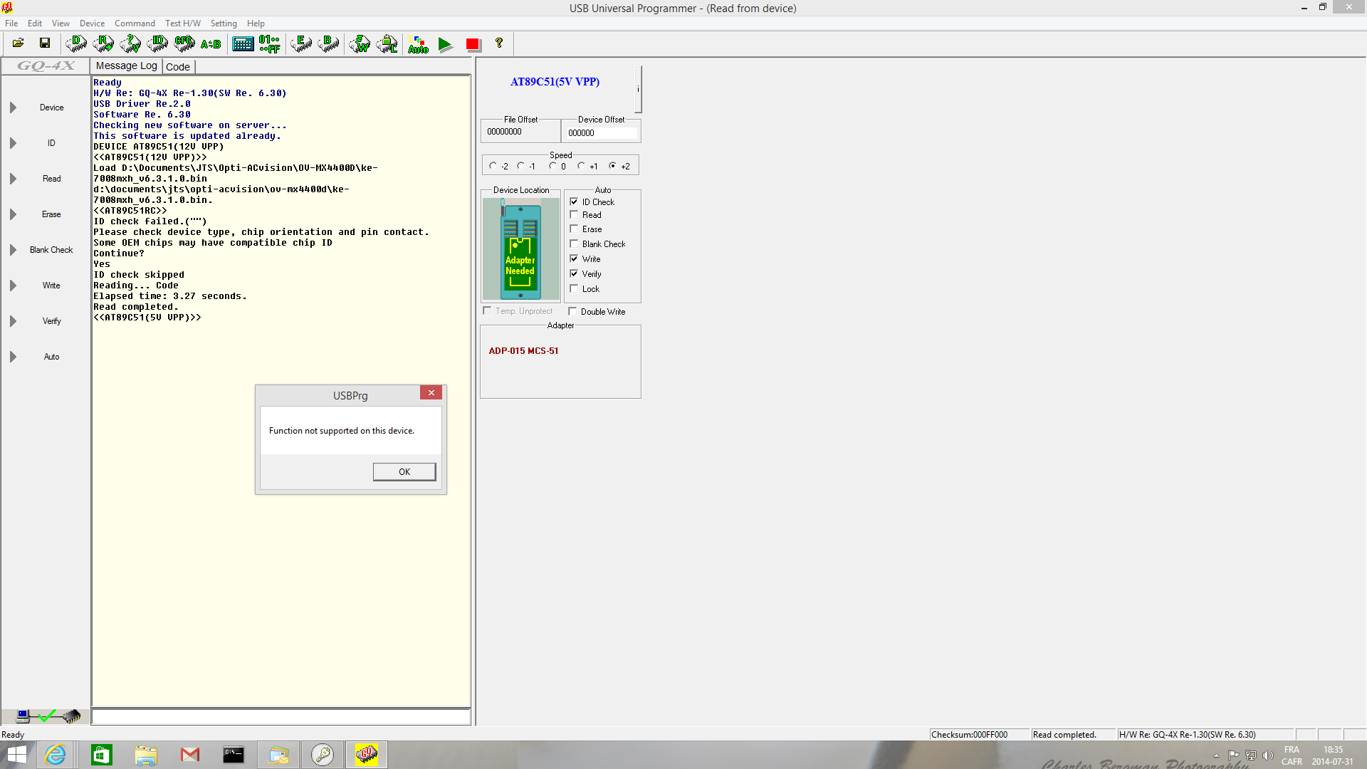

Trying to read a AT89C51ED2-UM. Programmer gives me "Function not supported on this device". Same thing with AT89C55WD. I am using adapter ADP-015 MCS-51. Anybody have a solution. Thank you.

Try:
http://www.mcumall.com/download/TrueUSBWillem/USBPrgSetup6.31.exe
