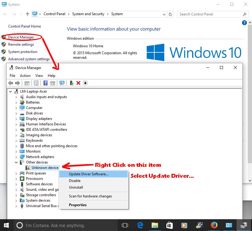

Download and then unzip the driver files into a directory. The latest Windows 10 USB driver 3.0 from here:
http://www.mcumall.com/downloads/download.asp?DownloadID=56
Update the GQ-4x4 (GQ-4X V4) USB driver Re3.0 from Device manager of Window 10
step 1:

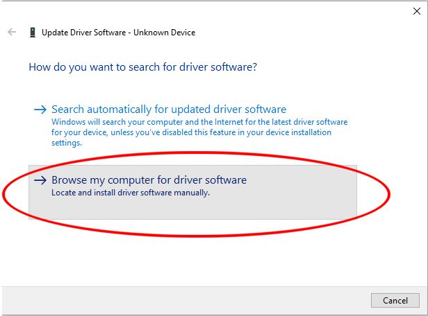

step 2:
38107 bytes

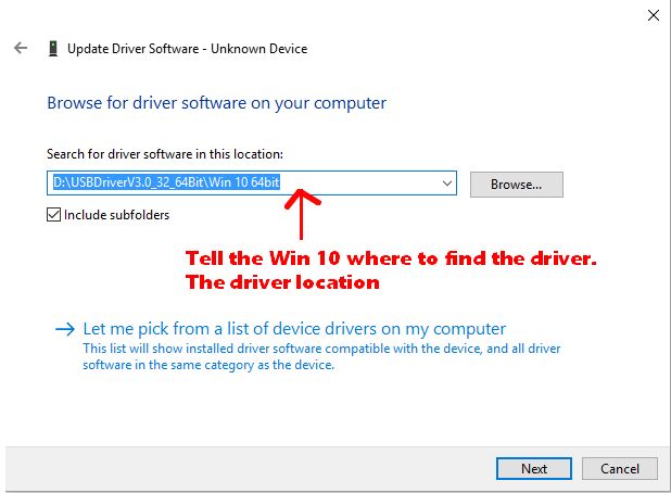

step 3:
39751 bytes

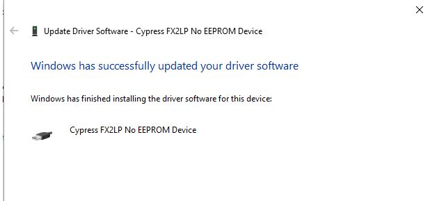

step 4:
16471 bytes

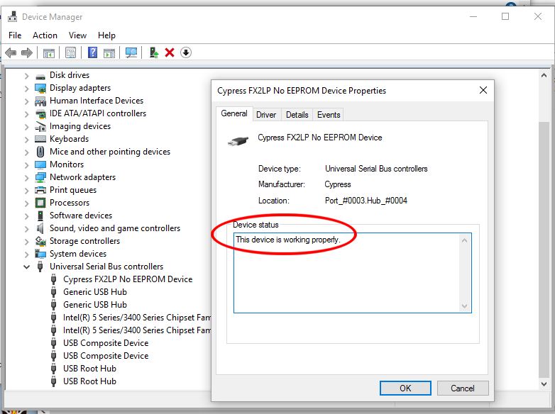

step 5:
78839 bytes

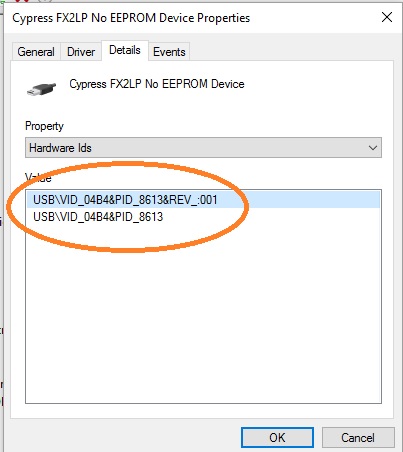

Posted - 05/12/2016 : 19:57:01
Confirm the hardware ID must show as followings.
38522 bytes
