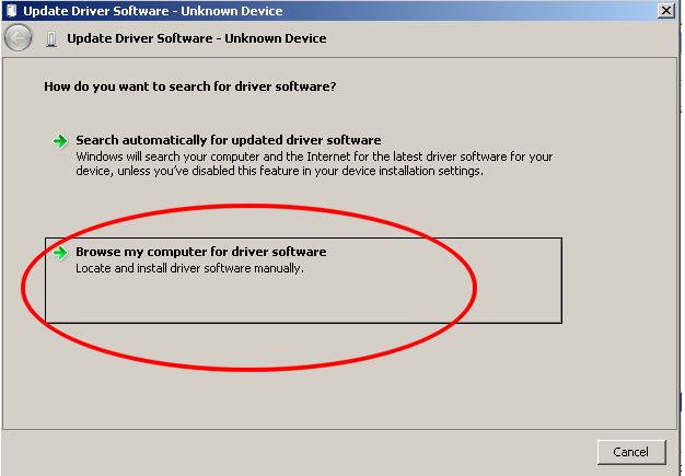

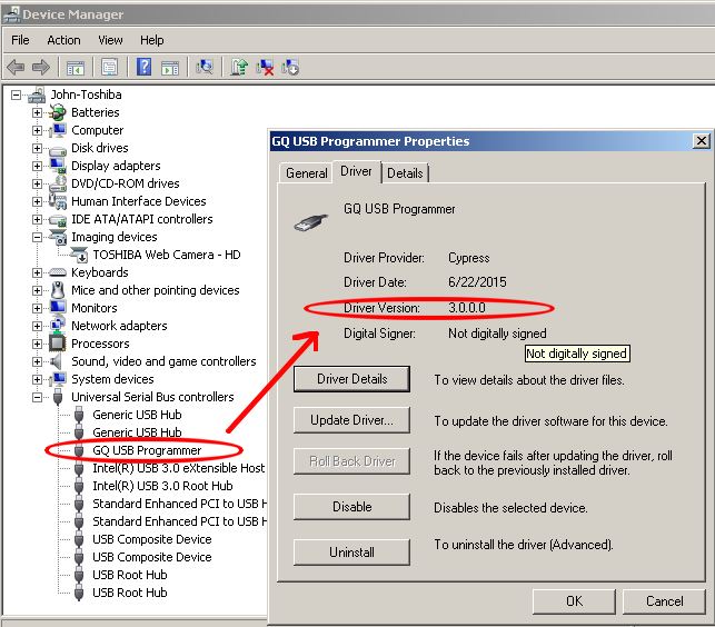

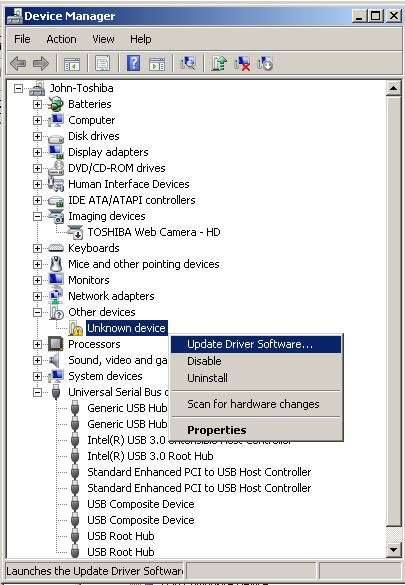

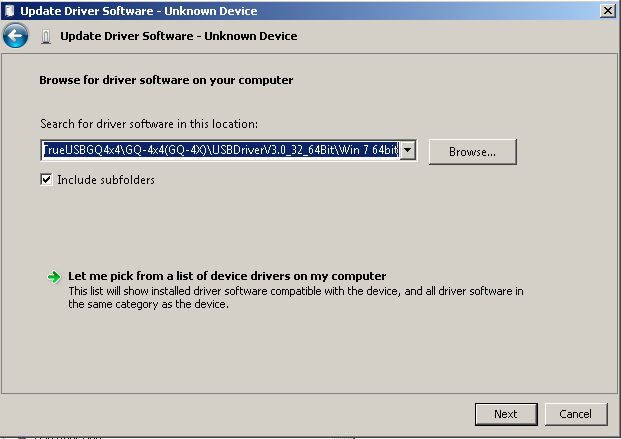

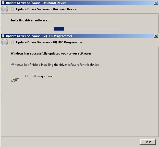

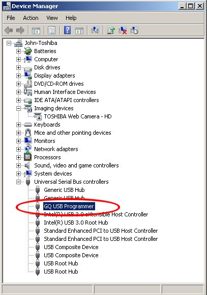

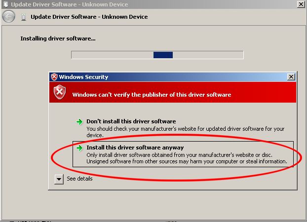

Start from Widows device manager:
The Win XP should use Win XP subfolder name.

My computer is windows 7 64-bit. When i choose the driver it says it could not find the driver on my computer. ive tried this with every driver i could download and none work.
Posted - 10/23/2016 :  06:15:18  Show Profile  Reply with Quote
Do you have a GQ-4X or a GQ-4X4?

Thanks ZLM I finally got it working thanks to your post.

Originally posted by EdwardBallou
Driver seems to have installed fine in desktop with Windows 7, but it still wont work
Any error message?
