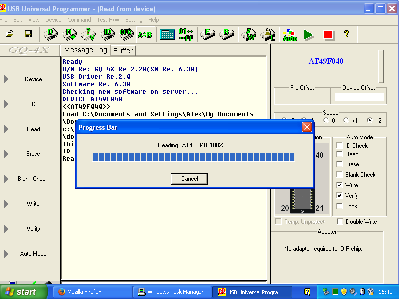

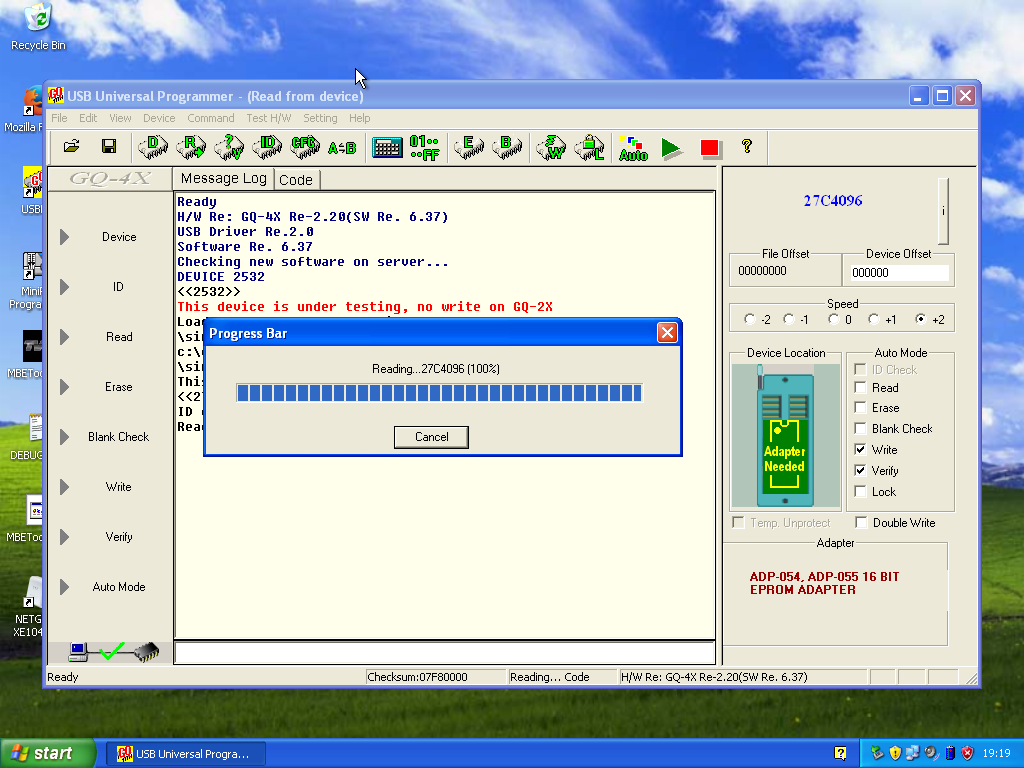

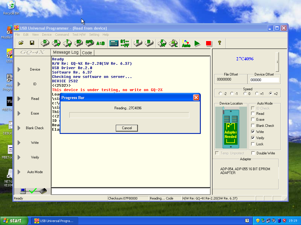

Trying to read / write AM27C4096 EPROMs however on every read or blank check, the program hangs at 100% and never recovers
I've tried adapter / no adapter and most of the jumpers J5 etc. but no different what ever I try - still freezes at the end of reading or Blank check
Any suggestions?

Posted - 07/22/2016 :  13:23:59  Show Profile  Reply with Quote
Update to latest software.
Also, try to read without the adapter and see if the problem goes way.
Try another USB cable.

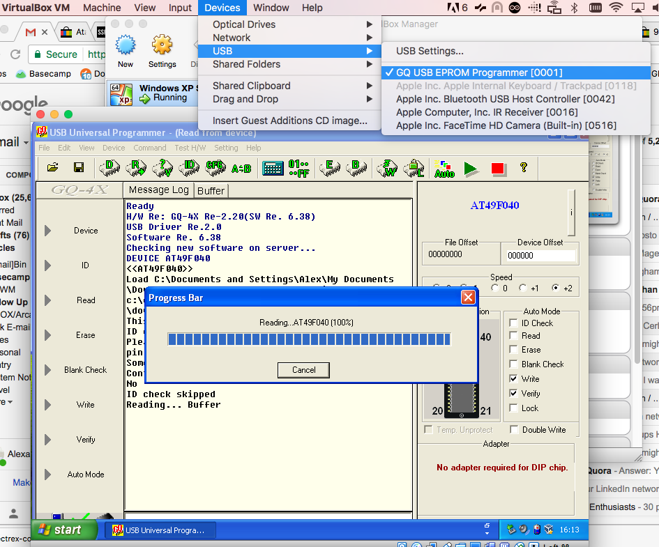

Posted - 01/15/2017 :  08:19:28  Show Profile  Reply with Quote
Thanks for the reply
Without adapter and chip, the software still hags on these size devices
I can't think it would be the USB lead as the device reads 2716, 2764, 27256 etc. all fine without crashing

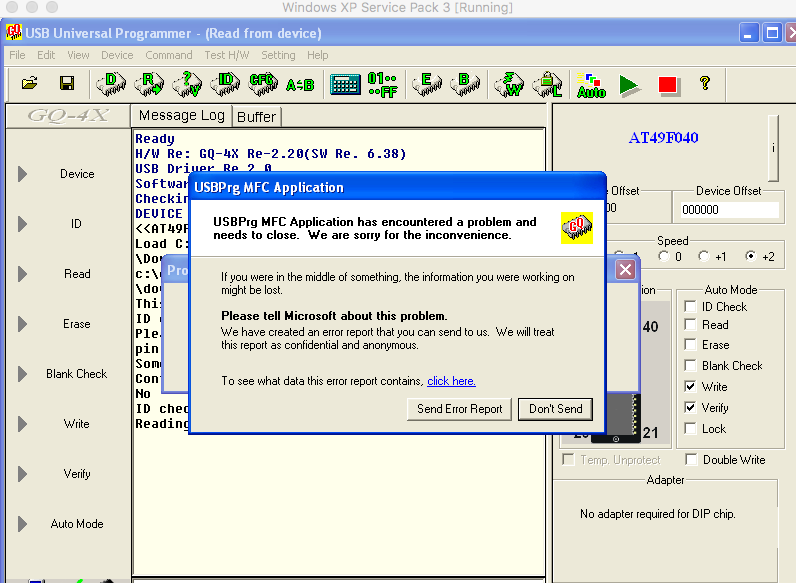

Programmer is also on latest firmware release, BUT I am running on a virtual XP environment on a Mac with Virtual Box so there may be some conflict here between the environments (*although not with the chips as mentioned above)

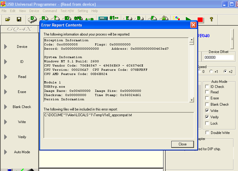

If I disconnect the USB device at the point the software hangs, that it crashes as per second screen (and leaves the USB process still running)
