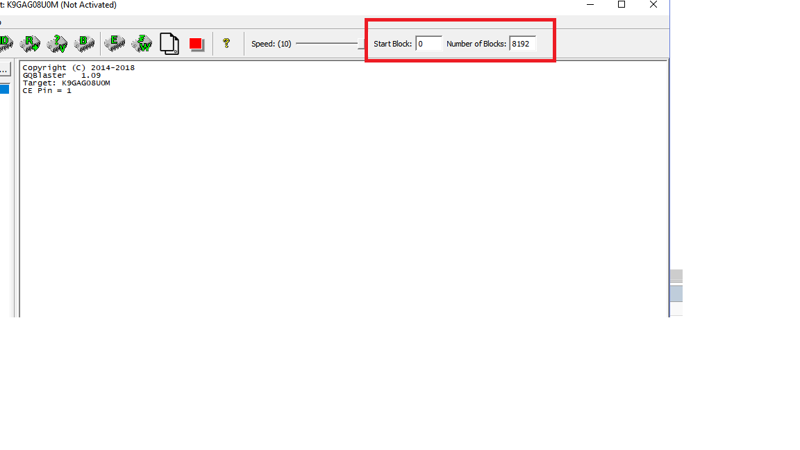

Dear guys please HELP!
I received my GQ-5X finally. However I cannot fix the TVs I have in my repair shop. I tried different dumps - no results. The TVs go in loop. All the dumps I have came from different sources.
Does anybody have a dump for NB41-01661 that was copied with GQ-5X?
I need it badly. I am struggling for months. Please help. Thanks.

Posted - 07/21/2017 :  04:17:27  Show Profile
What chip is it? How did you get the source file?

Posted - 07/21/2017 :  06:47:06  Show Profile
And another question. My dump files are bigger than the size that is written in the Nand.txt file. My files end with 88A7D7FF address and in the Nand.txt it is written 86D00000. Which one is correct? Maybe I should change Nand.txt?

Posted - 07/21/2017 :  06:48:28  Show Profile
The chip is K9GAG08U0E. The were copied with different programmers.

Posted - 07/21/2017 :  07:54:43  Show Profile
Yes there was an error in the nand.txt change it to
Name="K9GAG08U0E",MFG="Samsung",ID1="ech",ID2="d5h",ID3="84h",ID4="72h",ID5="50h",ID6="42h",size="88A7D800h",PageSize="21b4h",BlockSize="80h"
I am going to release 1.09 soon and it will contain over 400 NAND definitions.
Download Attachment:
47293
The file uploaded here is in progress. Newer software will handle this file better. You might see more duplication with this file since the IDs are too short.
However if you specify the chip it will work.

Posted - 07/21/2017 :  22:59:51  Show Profile
Yes, I changed the nand.txt but no result again. I am using 1.07 version and Smart copy mode.The TV goes in loop with the dumps I have. By the way, one of my dumps works fine except smart menu if I program it on RT809H. If I use GQ-5X for programming the TV goes in loop. Does anyone have a working dump for Samsung 5500 series MB BN41-01661 nand K9GAG08U0E? I need it badly. I bought three programmers including GQ-5X but got no result. Please help.

Posted - 07/22/2017 :  08:20:22  Show Profile
Why not use 1.07. It uses different algorithm .

Posted - 07/22/2017 :  09:11:38  Show Profile
I did not get it. I AM using 1.07. Is it faulty? Then which one should I use to finally get it done?

http://www.mcumall.com/comersus/store/mcumall_download.asp
Newer release is there for a reason. If you have not tried latest version then try it first.
Reply #31
GQ5XSupport
104 Posts
Posted - 07/22/2017 :  14:48:02  Show Profile
If you just do pure copy then there is no difference between 1.07 and 1.08. If you want to "Fix" the bad block which is normally the case then try 1.08.
Basically when it is not "working" is because your target chip and source chip has different bad sector map. 1.08 has slightly different algorithm than 1.07. However there is no guarantee it will work.
This is like older days when we use floppy disk (or hard disk) when they have the bad sectors, if you do "disk copy" the target disk files may not be accessible. However if you do file copy your files are perfect but the disk images are not exactly the same.
When bad block is in the firmware area, the "smart" copy normally will work OK. When the bad block is in data are, the smart copy might not work since unless the "file copy" method is used.
There is no universal "file" copy yet to be known.

As of the bad blocks,
1. I have purchased TNM5000. I do not see it has the capability to handle bad block better than GQ5X. I will add support to bypass the blocks. See picture.
2. We provide NAND programmer to program the NAND flash. We are not making NAND flash working on TV system which the OS not known (most likely linux). We provide tools like diskcopy not file copy. Third party software might need to generate proper file for the TV for particular chip. We have done some simple tricks to BYPASS the bad blocks. TV most likely are using Linux as its OS. In linux there are several file systems like SquashFS,jffs2 etc. Even for SquashFS there are versions of it. Each one might handle bad blocks different. In old days, on a DOS system, there is a FAT table to mark the data and bad blocks. IF that is the case, for each bad block the FAT table needs to be modified as well as the data needs to be moved to different location. These are done by the OS not the software that do the copy. An older days diskcopy will not do the work a file copy does.
If the algorithm of the bad blocks for TV system is known or documented somewhere, we are more than happy to put in our software.
3. My understanding is that if the bad blocks is in the firmware area, the skip bad blocks works fine which is already in 1.08. If the bad blocks is in the data area, the current algorithm is not sufficient and I do not know any programmer can do it.
This bug is fixed in the current version but does not affect the Samsung firmware since the end of the file is blank.
If it goes in a boot loop you didn't follow the instructions correctly before making the dump.
Makes no difference the end of the files contain no data.
+1 True.
