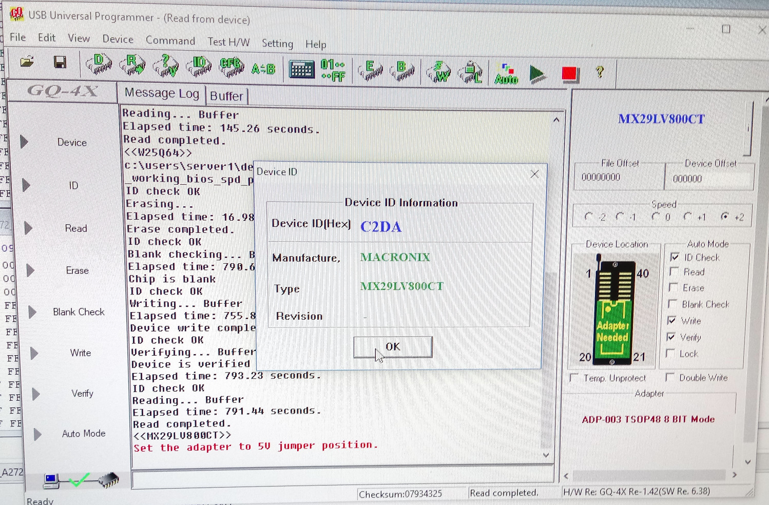

Maybe the chips is not connecting to the adapter pins properly. I have just tried a near identical chip in my GQ and you can see by the screen shots it works OK.
NOTE: My chip is slightly different to yours, mine is 29LV800CT hence why chip ID is different.
