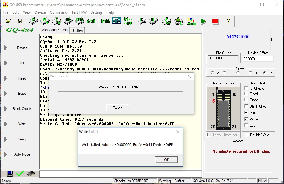

good morning, sorry my bad english, I have some problems with the programming of some chips (27c1000 / 27c160 / 27c322). I often get the error as in the attached photo. I state that:
- before writing the chips, I always delete them
- use of win 10 (also tested with win 7 but without any improvement)
- latest software version 7.21
- I also tried with a new programmer but with no results
do you have any idea ???

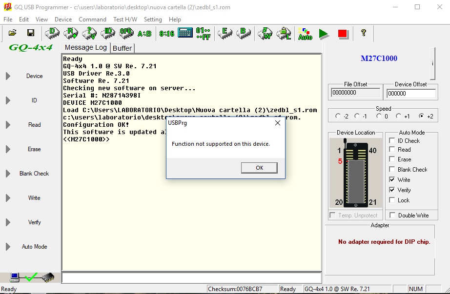

The chip ID does not detect me. I do not know if it is normal or not, the example above is with the 27c1000 but it does me the same with the 27c160 and 27c322 (mounted with adapter).
75alessandro
Italy
8 Posts
Posted - 09/25/2018 :  05:06:18  Show Profile  Reply with Quote
ID device (for 27c1000/27c322/27c160) function not supported!
2632 Posts
Posted - 09/25/2018 :  05:37:14  Show Profile  Reply with Quote
ID should work for the 27C1000.

with 27c1000 not working ..... I have exhausted my ideas ....

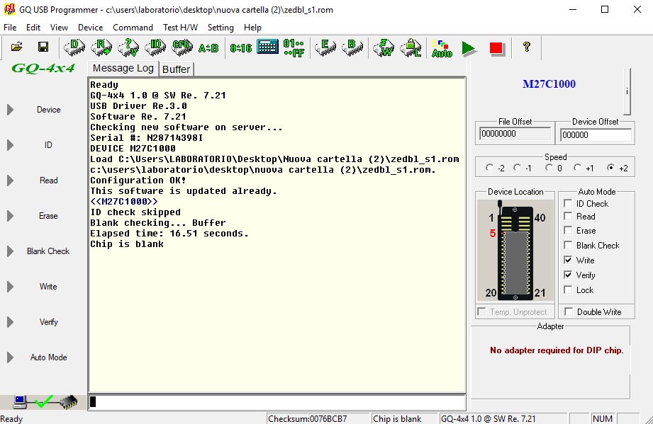

Posted - 09/28/2018 :  04:41:15  Show Profile  Reply with Quote
tried, unfortunately, nothing changes. I have exhausted all my ideas

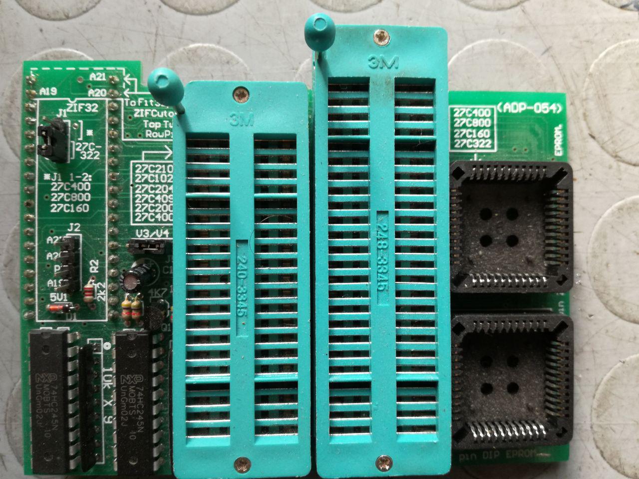

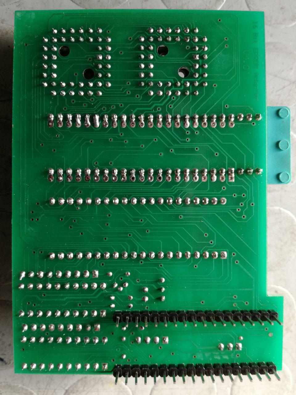

Can you take a picture of adapter? Backside too?

I do not think it is an adapter problem, with the 27c1000 without adapter gives me the same type of error that gives me with the 27c160 / 27c322 with adapter
204380 bytes
174941 bytes
Posted - 10/07/2018 :  07:17:41  Show Profile  Reply with Quote
Sorry. The M27C1000 does not need adapter.
Your adapter looks is not in a good condition.

Soldering doesn't look so good.
Posted - 10/07/2018 :  16:53:58  Show Profile  Reply with Quote
If possible buy the latest version adapter ADP-054 V4.1. That works more stable.

but the problem is before the adapter; to write the 27c1000 I do not need the adapter. sometimes he writes to me, sometimes not. I tried to buy 27c1000 / 27c160 / 27c322 from another supplier; excluding the programmer (tested with a new gq-4x, but the problem remains), usb cable, may be: bad chips or some error due to the operating system / software (win 10 + usbprog 7.21 + driver 3.0) or some incorrect setting of the program when writing.
