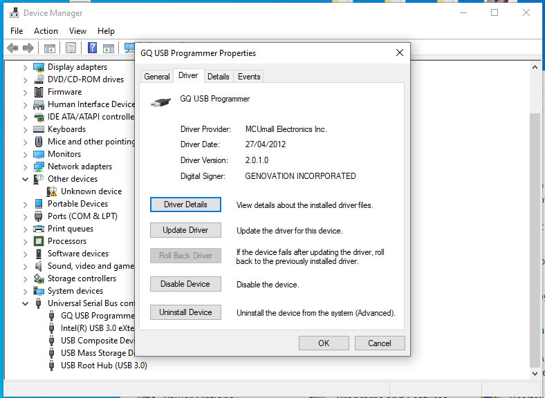

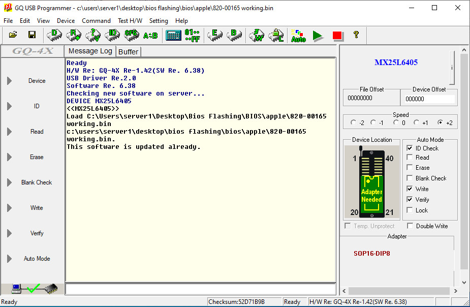

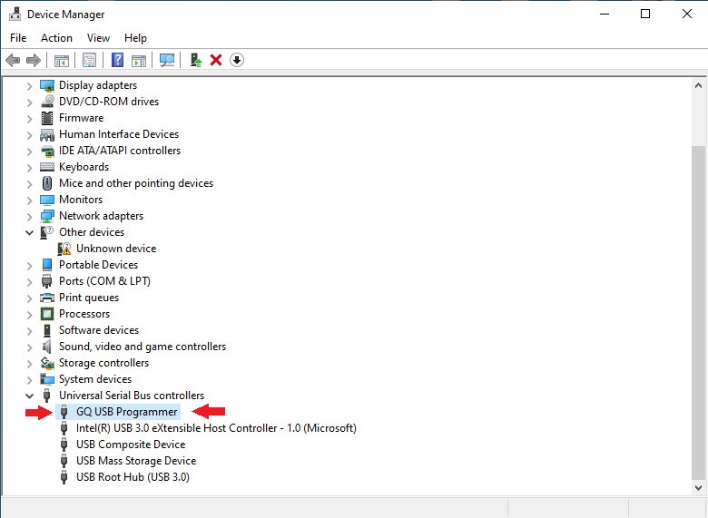

To make sure your GQ-4x is working properly, confirm that what you see in the screenshots matches that of your computer.
1 - Programmer detected in device manager:
83933 bytes
2 - Device driver is detected and working properly:
141793 bytes
3 - GQ-4X Program runs properly:
144942 bytes
The next two steps will only work if the GQ-4X is detected properly (i am not 100% sure about this though)

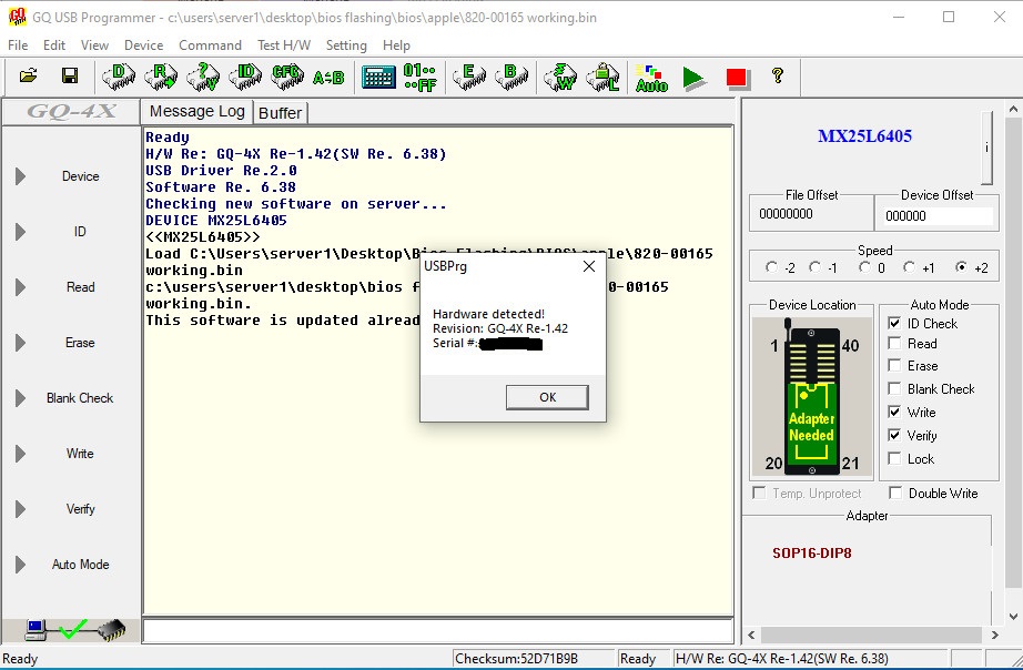

4 - Run Detect Hardware:
From the GQ-4X program, on the menu bar click on 'Test H/W' then on the drop down box select 'Detect Hardware', if working the following should appear:-
158283 bytes

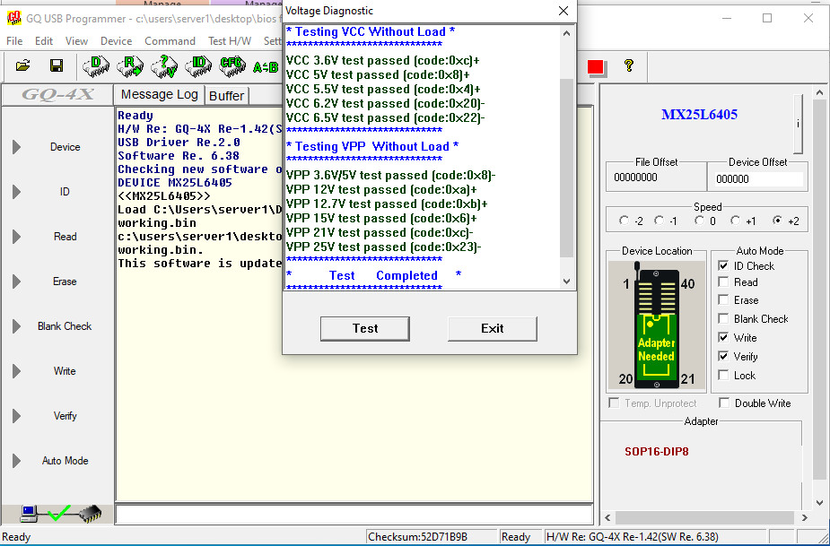

5 - Test GQ-4X voltages:
From the GQ-4X program, on the menu bar click on 'Test H/W' then on the drop down box select 'Voltage Diagnostic', run the test and if working the following should appear:-
179447 bytes
I am running windows 10 and as you can see by the screenshots, the GQ-4X is detected by the computer because it shows up in the device manager and you can see the device driver is running OK. This means that the USB hardware on the computer and the GQ-4X and the USB cable connecting them both are working. It also shows that the device driver was installed properly and is working properly.
For your GQ-4X to work, step 1 & 2 need to be working. If what you see on your screen is not the same as what you see in the screenshots then you have a hardware/device driver problem. If they are the same then you can move onto step 3 which shows the GQ-4X program running.
To confirm if the GQ-4X program and programmer are working you need to run 'Detect Hardware' which is under Test H/W on the programs menu bar. If the program can see the programmer it will display what you see in step 4, a box saying 'Device detected' and the serial number of your device. If your programmer is not detected then it means there is an issue with the software and programmer detecting one another. As has been mentioned in other forum posts, this detection will fail if the programmer is a fake one. There are many fake GQ-4X being sold which causes a lot of problems with the genuine device drivers and software that is downloaded from the official support site. Is your GQ-4X a genuine one purchased from MCUmall?
The last step tests the integrity of the programmer by checking if all the voltages are working. If any of these fail then the programmer is faulty.
There is something i have probably missed. I am not official support, just some who has the same programmer who is trying to help.

I make all that you show on the screenshots!
My driver works, the programmer pass on the voltage test.

Posted - 02/01/2023 :  16:35:25  Show Profile  Reply with Quote
I have not used my GQ-4X programmer in several years (purchased in Dec 2011).
Installed the software on my current computer (Win10) along with the registered drivers for the OLD version of the GQ-4X.
Drivers installed and confirmed via Device Manager.
USBPrg start, initializes and then hangs with a "Please wait..."
I have to force a close due to "Program not responding".
Anyone else having this problem and have a solution to fix it?

Posted - 11/15/2023 :  12:39:17  Show Profile  Reply with Quote
GQ-4X should still work with Windows 10 latest version.
Just make sure the signed USB driver Re2.01 is installed. Do not install the 3.0 USB driver which is for GQ-4x4.
Here is the signed USB driver Re2.01:
https://www.mcumall.com/downloads/download.asp?DownloadID=55

Fruitcake
Posted - 11/19/2023 :  15:44:23  Show Profile  Reply with Quote
I am using the signed v2.01 driver, but it just hangs at start up when trying to detect the hardware. I've resorted to setting up a Windows 7 VM and it works from there, but on the host Windows 10 PC it just hangs no matter what I try.
