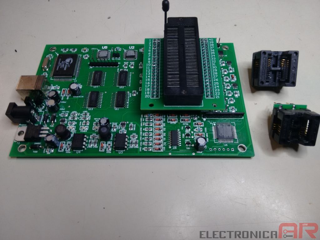

Hi colleagues, i've a problem with my GQ-4X. I need reschedule a MX25U6435F but it hasn't available in the Software Re. 6.38.
This is the data of the my GQ-4X.
i'm need use with a adapter SOP8 200M
GQ-4X Re-2.20(SW Re. 6.38)
USB Driver Re.2.0
Software Re. 6.38
What do i do?
thanks

I saw this topic but i don't have this adapter. I've SOP 8 to 200 M and SOP 8 TO 150 m.

You need ADP-099. This chip is 1.8V and maximum voltage is 2.4V. So, it will be damaged without ADP-099.
