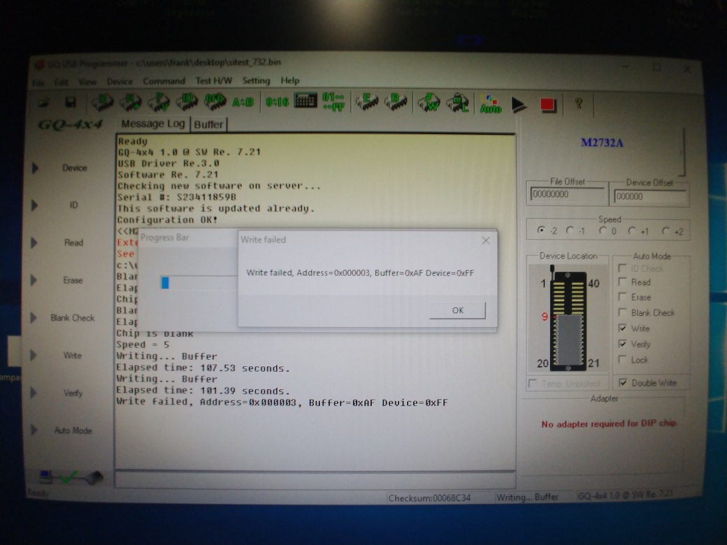

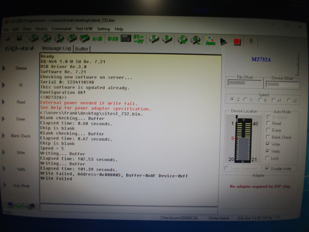

I have a GQ-4x4 and an external power supply 9v 600ma. I plug in the external power supply and get a green power led and then plug in the usb cable. I have tried device M2732A and 2732A. I have tried both of these on 10 different M2732A-2F1 chips. I get the same error when trying to write on each chip. The chips are blank checked twice before writing. The error I get is: Write failed, Address=0x000000, Buffer-0x00 Device=0xFF
I could definitely use some guidance.
Thank you.

After the failed write, a blank check reveals this error: Device blank check failed at address: 0x000800, Read= 0x00
This error shows up for all 10 chips when blank checked after the failed write attempt.

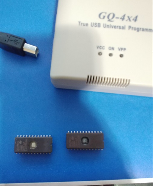

Are those chips "new" from China?
galactimus
10 Posts
Posted - 01/05/2019 :  17:21:11  Show Profile  Reply with Quote
They do look newish. I purchased from a US seller. Got here in 2 days. Could very well be from China. They are marked ST.
Frank
Posted - 01/05/2019 :  17:22:45  Show Profile  Reply with Quote
Is the lettering gold coloured?

Posted - 01/05/2019 :  18:32:47  Show Profile  Reply with Quote
The data in 0-2 slots are 00 in both the buffer and the eprom. When it gets to slot 3 it doesn't write the buffer value of AF and fails. When I read the device after the fail slots 0-3 are 00.

I wanted to follow up here for anyone else who has this issue. This is what I found. The chips I purchased are from China as it turns out, even though they came from a US supplier. I ordered M2732A-2F1 eproms. On the chips they have that label and 21V Fast and the ST logo. I tried the following devices in the GQ software, all with failed writes: M2732A, 2732A 21V, 2732 25V. I then thought what the heck, why not try the 2732B 12.7V device. Sure enough, the eprom wrote and verified. I also read the eprom and did a hex match to the file I wrote to it, outside of GQ software just as an added check. Everything looks good.
So, it looks like the Chinese are making chips and either have no idea the differences between models or they just don't care and mislabel them. The chips do work, they just aren't the model printed on the chip.

Good find, you definitively got fake chips! They pull old chips off the junk heap and print them with a part number they have demand for. You now have "new" chips.
Does the part number seem printed or engraved? If printed you may be able to remove it and the blacktop with acetone or lacquer thinner an see the original numbering.
