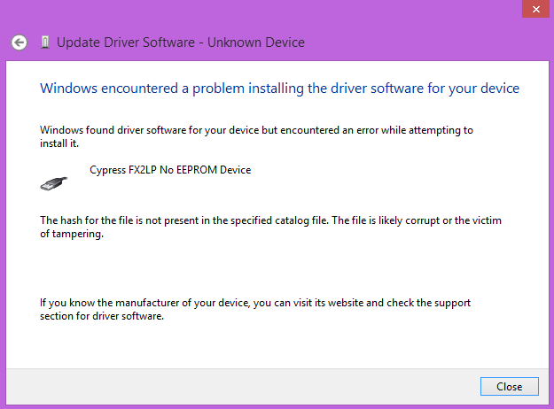

In the Driver tab and after browsing for the file in the "Update Driver Software" window I get the attached error

Posted - 08/11/2018 :  04:36:07  Show Profile  Reply with Quote
I finally got it to work.
I had an old XP machine and still had no luck. Pretty much the same error.
I decided to just test each driver. The one that worked was the GQ-5X\USBDriverV3.0_32_64Bit\Win8.1\x64.
