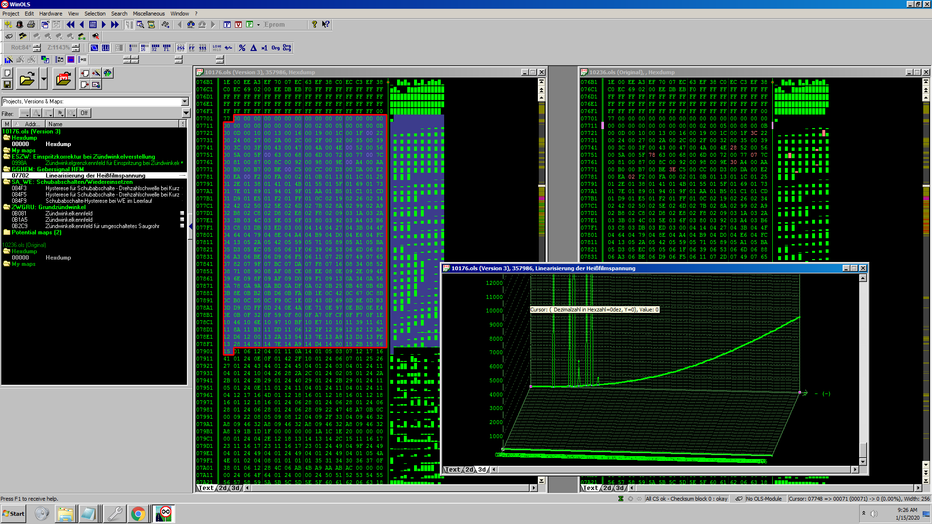

so unfortunately for me i bought this burner for one specific task and that was to burn chips for my older vw. from square one ive had issues with this burner. when writing verification fails and if you read the original file back off the chip not all bits are the same as the original. also if i try to erase the chip the burner will hangup program freezes and never blanks chips. after doing some research this is a common issue with blanking chips with this burner. its quite upsetting because i bought this burner for the specific task and it simply doesnt work. anyone know of a burner that works with these chips as advertised or have a solution to make this gq-4x4 work? thanks
